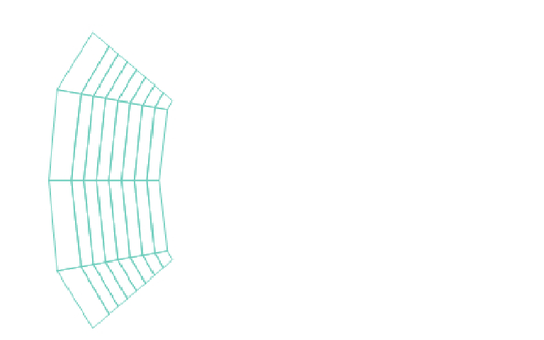

Hi I'm new in archicad and I'm student. I cant make steads (tribune). can any one help me.?

If it's just the STEPPED portion... you can just stack slabs... If it's fancier steps, you can use the COMPLEX PROFILE, draw it section then extrude as a wall..
If it the actual seating (individual seats).. then you may need to add each individually.
