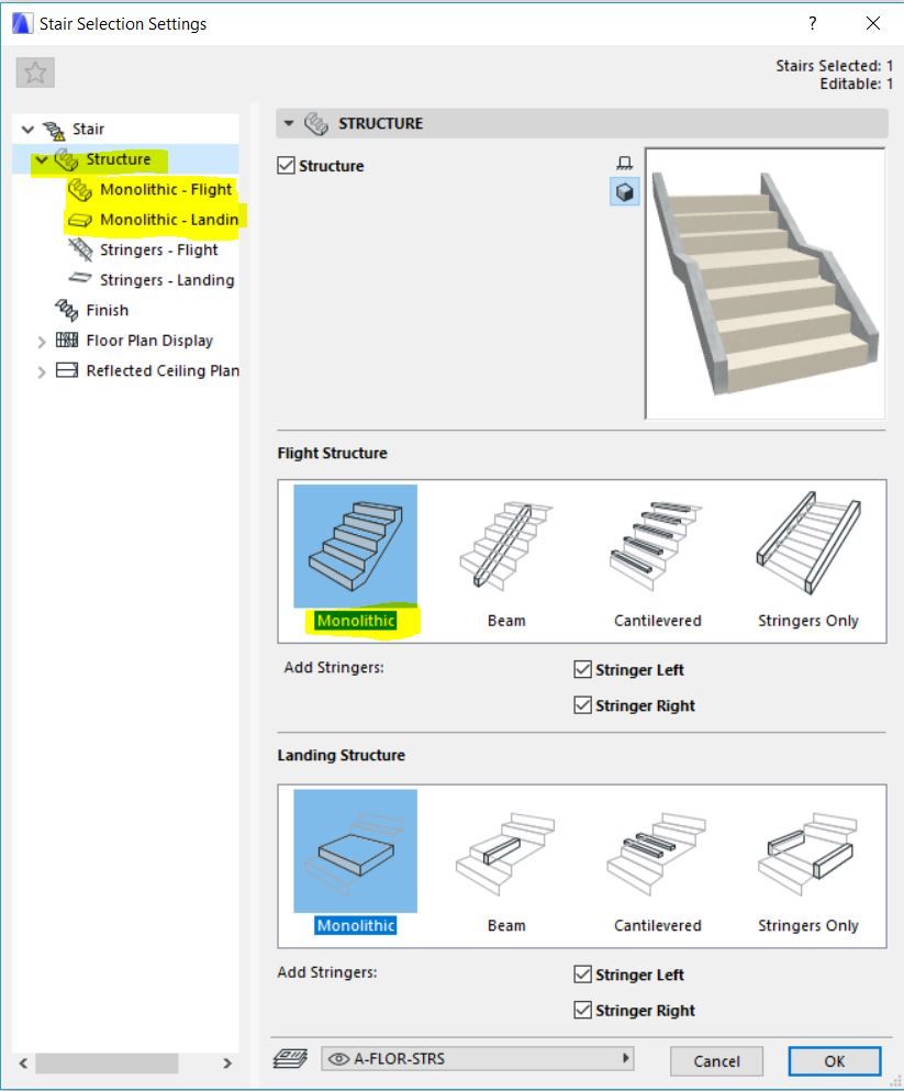

I cannot seem to find a wood structure option in the new stair tool. I can find only monolithic flight and landing that are more for concrete. Sure there should be other options.
2 REPLIES 2
Hi, the options are right there next to monolithic (Beam, Cantilevered, Stringer) it depends on which way you want the structure, and then you can change the profiles and materials of the stringers, Beams or any structure you use.
Thanks. I am testing it. I am beginning to get a sense of how the stair works.
