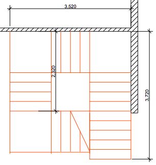

Does anyone have any suggestions for the best way to 'build' these stairs..
I manage to get to the third platform - but then gut stuck as I can't 'add' another flight.. but rather have to add an additional straight run but then struggle with the hand rails..
Speaking of which - is there anyway to make the handrails visible in the plan view - a way to activate their visibility in the 2D View?
Thanks for your time!

i've found the easiest way to deal with this type of complex stair is to break it down into simple components;
i would probably approach this by using slabs to model the landings and have each flight a separate object (although where you can set up flights to be identical, duplicate the flight).
as far as handrails/balustrades, depending on the proposed type and level of detail required, use angled beam tool, roof tool, trussmaker etc., to obtain the required structure/appearance. the main difficulty i've found is continuous handrails - although only a problem for curved or spiral stairs - sections of straight handrails are generally easy to join if required.

Cadimage StairBuilder could easily do these stairs as a single object or multiple objects. As has been pointed out eleswhere in this forum, making the handrails compliant with US accessibility standards (and maybe Australian standards) requides some tweeking but it is doable. StairBuilder is expensive for a one trick pony but it can make almost anything. Its one Achilles heal seems to be stairs with varying width......

I downloaded the demo for Archistair - and whilst it seems promising, I can't justify that expense for something that can be done manually (at this point in time).. plus I can't seem to manipulate the ArchiStair model to be a three landing stair.. (I didn't spend to much time trying though either - so if it can be done I trust you).
In saying that.. My real attraction to ArchiStair would be the easy manipulation of the handrails.. That looks great - so its purchase may be more in the near future for me than expected.
In the end I combined two L-Shape stairs with an adjoining platform - The hand rails will be another challenge another day.
