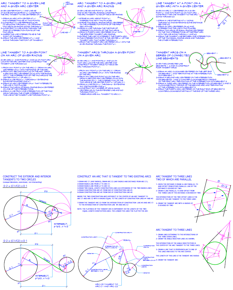

Hello,
Recently, I decided to collect all the tangency constructions
I had scattered around in various places and put them all
one 8 1/2" x 11" sheet. I wonder if someone here who is
interested in such things would look at this "sheet" and
see if other tangency constructions need to be included
and if so let me know which ones.
Thank you,
Peter Devlin

Here is a PDF of the same "sheet"
Some really useful tips there Peter, and beautifully presented! Many thanks for taking the time to upload them!
Hello Peter,
Thank you.
I did find one more tangency construction
that I hadn't included and that was,
tangent line through an exterior point.
Thanks,
Peter Devlin
