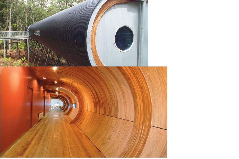

Vertically Curved Roof&Wall in AC11
2008-04-28
08:46 AM
Hi, does any one no how to create a Vertically Curved Roof&Wall in AC11, these attached pictures should explain it.
www.tastimber.tas.gov.au/Species/pdfs/16%5Bprint%5D.pdf

Use your complex profile feature with a wall to extrude the basic shape and add other complex profiles as supports.
