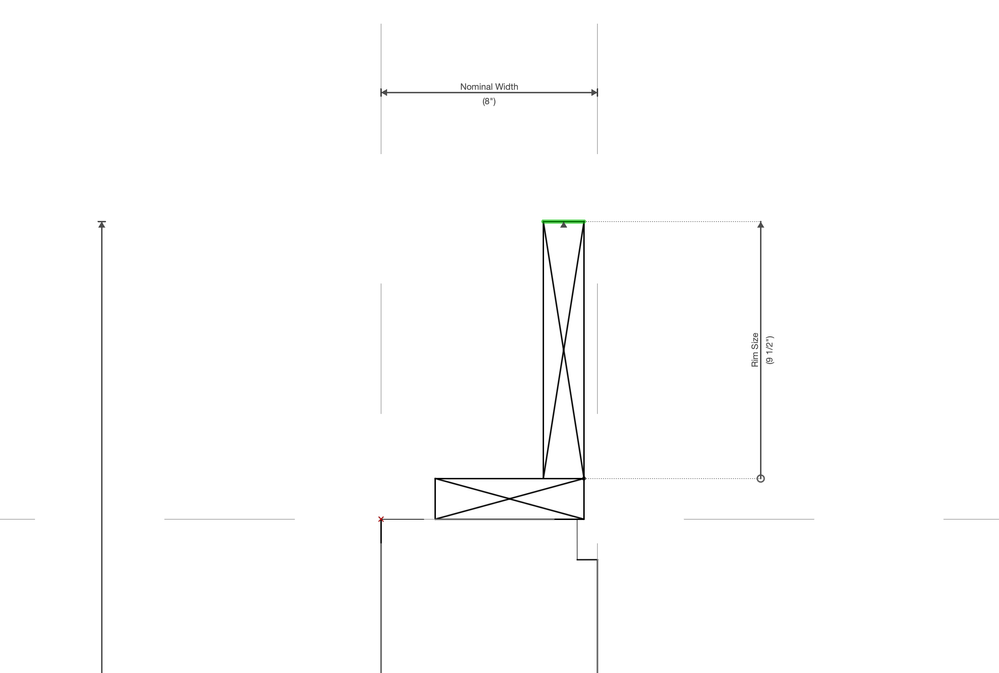

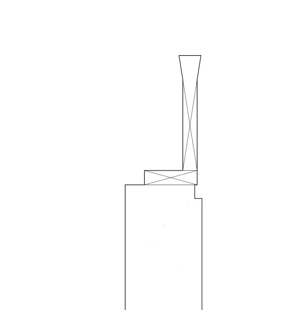

Hi All I'm trying to modify a stock complex profile to make it better reflect how i use it. i have the foundation - concrete + wood plate + rim. in the real world the rim board may change depending on the floor joists. the rim board is composed of 4 fills what i can't figure out is how to get the entire rim to stretch. it looks to me like i need another set of stretch modifiers, but i haven't found anywhere that explains how to add them. you can see what happens when i add a modifier and change the dimensions.

The problem is because you have split your rim board into 4 triangles.
The stretch modifier just stretches out the edge and because the sides are angled that edge you stretch extends in width as well, simply extending the angled sides.
The same happens if you stretch the sides of a triangle fill in plan.
I am not sure there is any way to win this one.
We need an option to be able to stretch a single node in one direction - modifiers currently can only be applied to an edge.
Then you could add that modifier to the top corners of the 3 triangles at the top and that would stretch perfectly.
Except the centre point of the cross would mess up.
The top of the bottom triangle would not stretch, you would need that to stretch at half the distance as the top of the rim board.
The only way I can see this working is to have a single rectangle instead of the 34 triangles.
But I know that gets rid of the automatic X in the timber cross section.

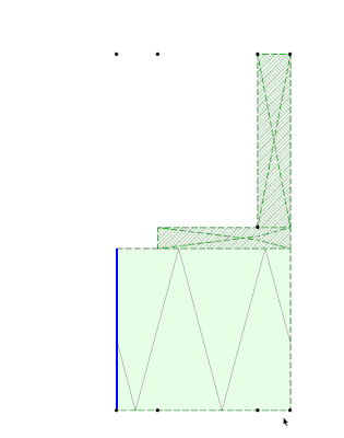

Well I also understand that there's currently no way to add more stretch modifiers, but aren't the two you get enough? Isn't this what you're trying to do?
True.
You can set the vertical and horizontal stretch zones to just the area of the top plates/beams.
But that means any time you change the wall height or width, it will only be those beams that change.
All other heights you will have to set modifiers for.
