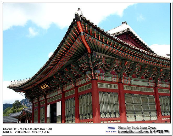

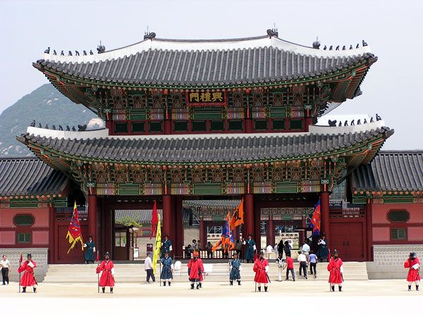

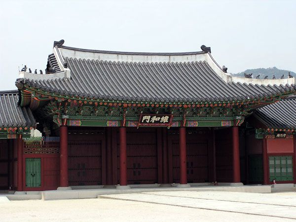

i need help for modeling
i would like to make a roof like picuture
how can i start
and
i woudl like to make librairy
help me pls
