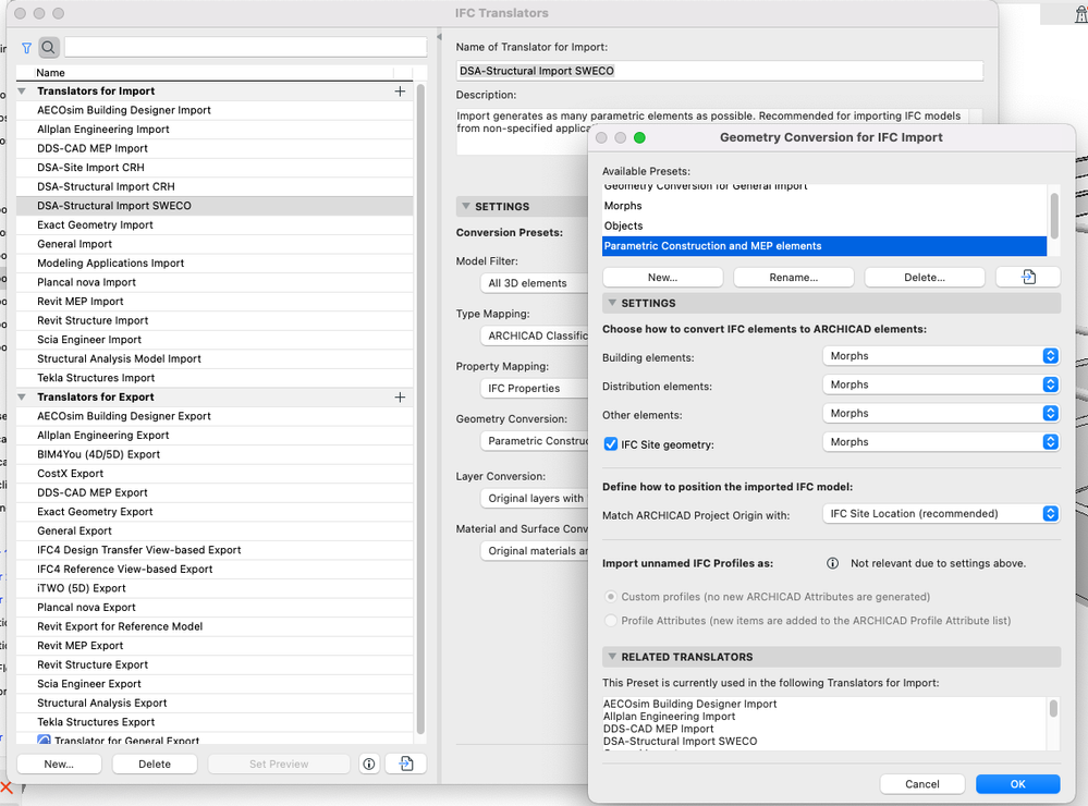

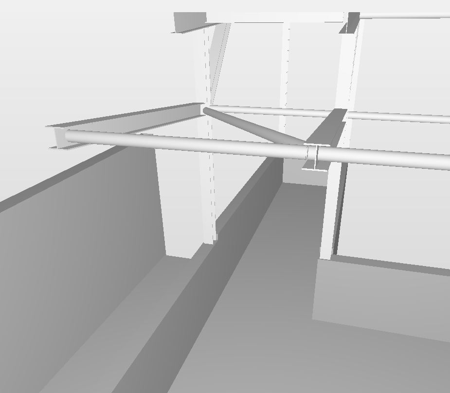

I import ifc file from Revit to Archicad 25 by hotlink module. It has some geometry errors. Image 1, I open ifc in solibri, it's very nice. Image 2, it has a error in Archicad 25. I add ifc transaltor setting in image 3.
I hope it clear and someone can help me with this issue. Thank you very much !

Hello @DatPhan,
What were the IFC export settings from Revit? What were the geometry conversion options in particular? If you do not know these parameters, you can try to use different IFC import parameters from Archicad which will undoubtedly be able to correct the model.
