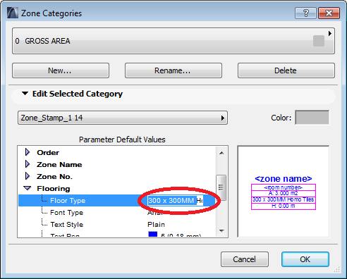

If I set the name for the flooring, as shown in the attachment(Circled in red). This would not be set in the Zone Tool when I select it.
Just to confirm.
No, only the Zone category NAME, Zone category CODE, and Zone category COLOR are modified in all elements. Any other setting is local.
The only way to modify with one change only all the names of a collection of identical Zones is to use the 'Zone Category Name' as the Name of the local Zone. (attached image) If you use this setting in all local Zones and if they target the same Zone Category, you will get the result you are targeting
