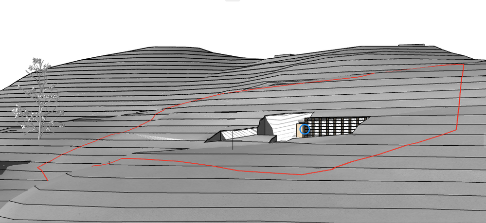

I use a morph line or a thin/small morph volume to indicate heights, borders +++ Shows both in 3D and in facades. Like in the image below.
sinceV6: I´m curious about this object you have made. Can you tell a bit more about it?
