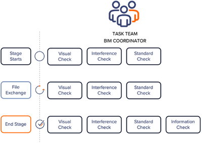

The BIM Manager should define the quality assurance strategy for the practice by defining:
  • Who will be responsible for the quality checks?
  • When will these checks be performed?
  • What will be checked? and
  • How to perform the checks
The BIM Coordinator is the most suitable professional for running quality assurance checks at the project level. They will have a good understanding of project development and will be able to ensure that the checks are done following the project timeline. Considering the project requirements, they will also know how to identify what needs to be checked, considering any project's specificities.
Here are the different checks that a BIM Coordinator could perform:
  • Visual checks to identify any elements that are redundant in the model. For example, by opening the 3d window in Archicad, you can navigate through the model, checking for flying objects, obvious element repetition,ns or missing elements.
  • Interference checks within the discipline model. This is internal clash detection. For example, you can check for door clearance or whether the ceiling height is suitable for the window arrangement.
  • Standards checks to ensure that both the internal practice standards and the agreed standards in the project have been applied to the model elements. For example, you can check if the layer naming follows the agreed naming convention.
  • Information checks within the discipline model to validate and verify the data attached to the model elements. For example, you can check if elements are correctly classified and have a unique ID, structural function, and position.
All these checks can be performed in Archicad using tools such as Graphic Overrides, Interactive Schedules, Collision Detection, or Model Compare. However, the BIM Coordinator should also be able to use different software, such as Solibri, to perform any required additional checks.
