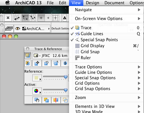

Dose anyone know what happened to ghost layers in arch 13? I cant seem to find where to turn them on and off.

Now called Trace & Reference.

It is now called Trace and Reference.
You can right click on any storey, section, elevation, detail, view point or layout and choose "Show as trace reference".
This can be done from anywhere also (any storey, section, elevation, detail, view point or layout) so you can have a trace not only in a floor plan but anywhere else too.
The trace palette needs to be turned on so you can control the trace (ghost).
ALT-T is the shortcut on Windows.
