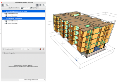

Hi @Strawbale23  - I'm not having the issues you explain. I can sympathize that building a watertight file for zones to work properly in ED/EE is not easy (ie. overlapping walls will cause issues, zones not touching surfaces will cause issues, and generally modelling for EE/ED to capture everything can be really fussy - but it is still FAR easier than manually entering information in another platform where elements will also be missed). As for my models being realistic or not - these are real projects under construction - realism has everything to do with LOD - and for schamatic phase modelling, LOD100 to 200 is all you need to get an idea of how a building form will perform.... I showed a single-zone model for schematic convenience but also a multi-zoned model alongside it. The attached image is from a 48 unit MURB - again no issues recognizing all structures in all zones and applying aggregate U-values to them appropriately - except for a few patches at balconies that have overlapping wall types - user error! Knowing what the tool is looking for may help - one can't expect it to capture values from 2 different wall assemblies within one-storey however, but one can easily model workarounds and it is still faster than jumping to another energy modelling software. If you are interested in more of our results we did have a LUND University master's student publish a white paper on this here.

Imho GS needs to update their instructional materials to cover how the tool functions, and what it can and cannot do.
