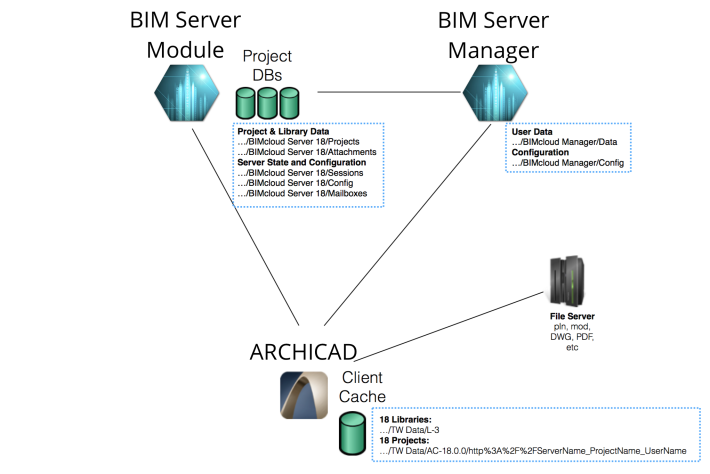

Teamwork Environment Components
The below diagram explains the different components of an example BIM Server Environment focusing on the data that can be used for the recovery.
Choose backup levels
There are three backup levels to choose from according to which portions of your BIM Server do you want to save off. It is strongly recommended to backup both:
  • Projects individually (1st level) in case only a Project file would get damaged, or if you would like to go back to an earlier version of the Project
  • the BIM Server application (2nd level) or the entire OS of the machine (3rd level) in case the installed application itself gets corrupt
