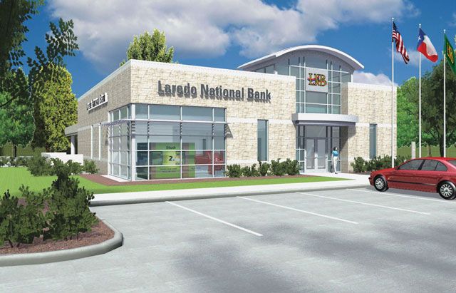

Critique please
See attached image.
Thanks!

Slightly over-exposed.
Foreground asphalt could be darker to anchor image.
Crop off foreground - why look at empty road?
Saturation - color intensity.
Fringing on trees distracting. What are you using?
two minutes in photoshop not great but illustrates a possible direction...

The "asphalt" is actually concrete, and that stone actually is a chalk white texas limestone, but I agree it is slightly overexposed. I always have problems with concrete it seems.
Cropping was done on the layout, but this is the original uncropped version.
Those fringy tress are the architerra billboards. I need to find some better ones than those. The foreground trees are the archibam 3d trees which I think look pretty good for what they are. Suggestions for better ones that aren't onyx?

PC users have several other 3D tree applications. I dislike picture trees because they only work for one sun angle. Oddly, that sun angle is the one they use in their promotion material.

I actually prefer Eric's original, just clearer and more cheerful. Could maybe do with a bit more depth in the windows (darker, more reflective, but that would obscure your interior too). Yeah, the fringes on the trees make them look flat and unrealistic.

Destauration in Photoshop is a poor way to make a point about oversaturated skies and foliage in general, and this comes from oversaturated colors in almost all Archicad material textures.

For trees I recently experimented and got the following (see image) using Tree 3D 01 (from AC9 Library, converts to Tree Deciduous 11 10 in AC10), They took a little while to render with shadows on, but I was quite happy with the results. Trunks and branches look a bit funky up close but they're o.k. for backgrounds.
Tree settings:
no. of leaves - 300, random leaf polygon nodes ON, leaf diameter - 1200, spreading - 500, angle of leaves 40degrees, tree diameter 6000, height 10000
leaf material - Evergreen which I modified with:
Texture space - Eroded (scale 0.1, coverage 0.5, Fuzz 0)

Wonderful look.
The eroded transparency shader gives the impression of many more leaves without the broken-shards-of-glass look.
