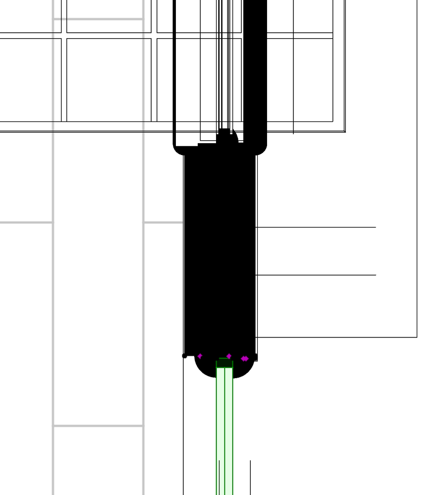

Thank you for your replies ahead. I am trying to clean these openings for presentation, editting a CI window.
Screenshot 2022-11-17 172652.pngScreenshot 2022-11-17 172718.pngScreenshot 2022-11-17 172853.png

it's extremely vague to me.
what's the problem exactly?

Hi @2raarchitecture ,
I'm guessing it is a line weight issue ?
If so, then you may have several solutions depending on what fits your best :
- turn off the true line weight (right click on an empty space or go to View > On-Screen View Options)
- change the weight of the specific pen in the pen set in question (Element attributes > Pens & Colors)
- change the 2D and/or 3D representation of the object to a lower LOD if possible
- change the scale of the view to a lower one
There may be others solutions as well but on top of my mind, those are ones that could help.

 thank you kindly for your replies and I appologies for any vagueness...the solution was to change the complex profile settings on the attached options. I figured this could be helpful when doing walls as complex profiles.
