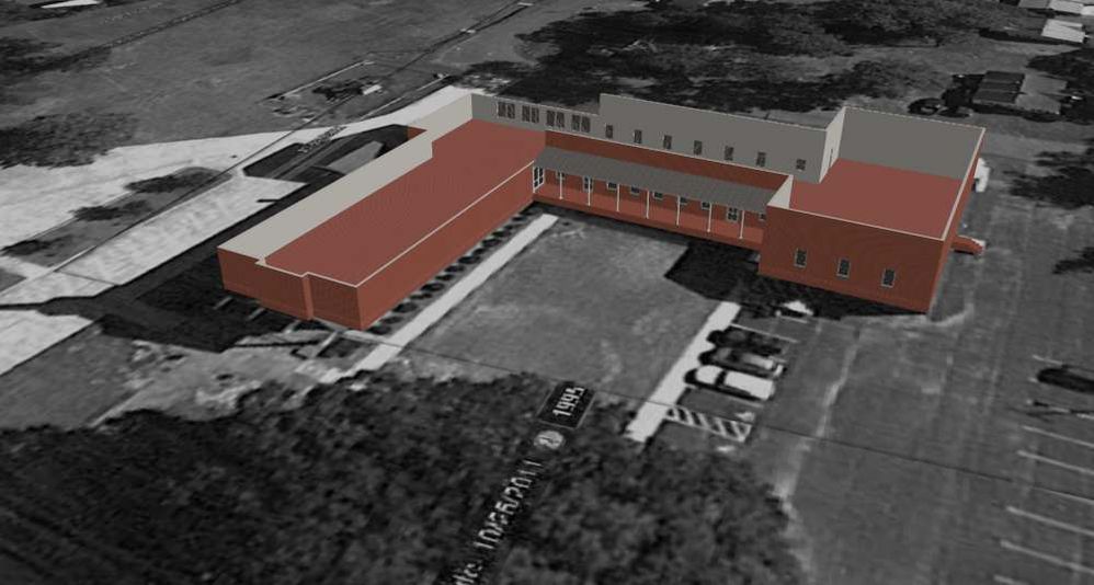

When using the snapshot function for the Google Earth Connection Add on, the Google Earth image comes into Archicad to the correct scale and orientation, which is very nice, BUT the image is in Black and White. I have looked through the Google Earth Connection manual and the settings within Google Earth itself and cannot find a setting to have the image be in color. Does anyone else have this problem. or how to fix it?
I have attached a Lightworks rendering showing the color building and the black and white images.

See Karl Ottenstein's tip here

Thanks, Erika. I should add another probably obvious tip - besides saving the color image from GE, to replace the B/W one, consider opening the color image in a photo editor first to do some adjustments. Besides cloning out some of the Google text (much of which can be turned off in the GE view options) - I found that to get a good Lightworks render, I needed to adjust the image levels a bit. For areas with water, the Google satellite imagery often shows splotchy odd colors. It's nice to smooth that out and overlay some blue, etc...
