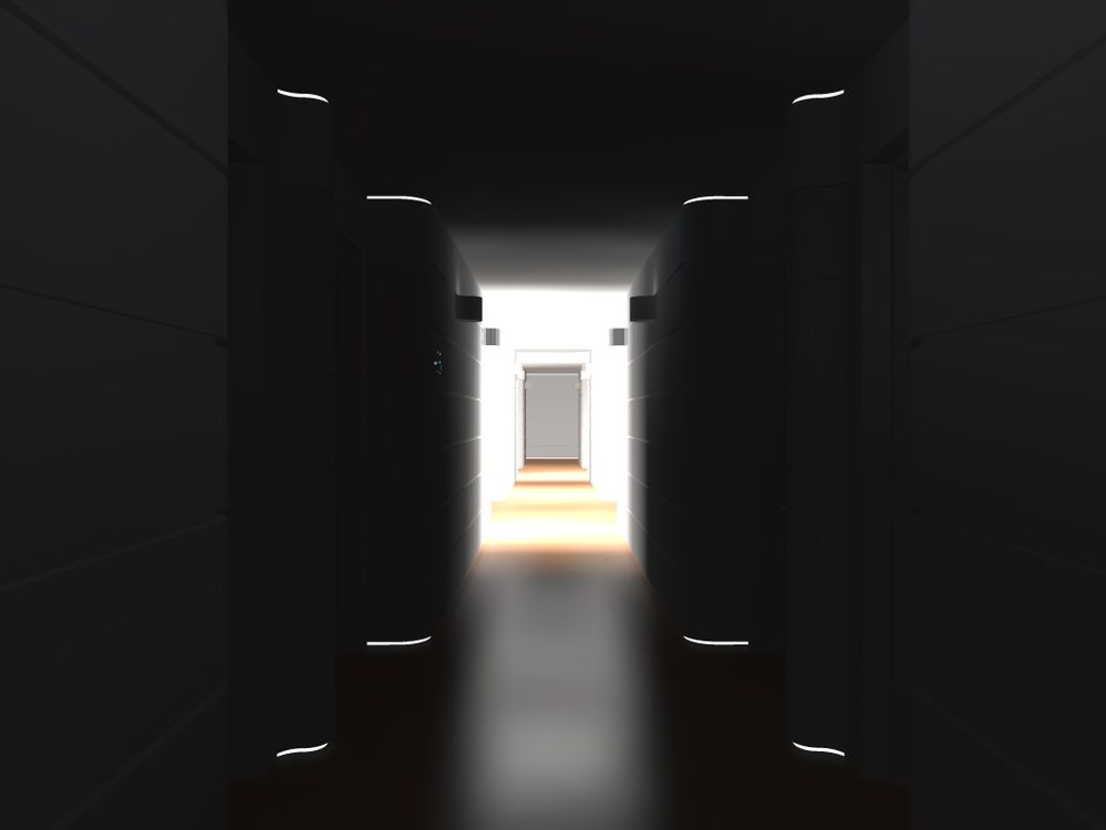

Just thought Id run this by everyone here as well as the Artlantis forum...
I am trying to get a soft glow along the top and bottom edges of the wall, so I have been trying use the neon shader to achieve this. However, I cannot get anything close to what I want, there is always an extremely strong glow at the end of the hallway, regardless of the power or neon settings, and it also seems like the portions of neon closes to the camera are simply just white with no glow...anyone know a better way to do this or the best settings?? Im completely lost....Im actually considering duplicating hundreds of small lights along the length but that seems a bit insane

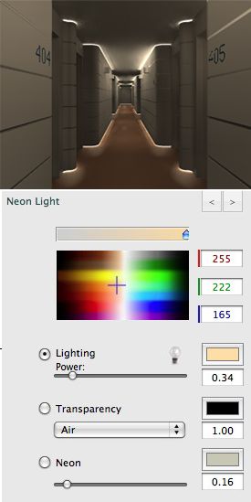

One of the ways I build my confidence in a software is to see how I quickly can solve a colleague's problem - in public. So when Sloan offered [his/her?] model, the game was on.
Dwight's Two Minute Fix™ of the model =
- turn of hall downlights causing hotspots
- switch crap neon glass shader to neon light shader: see settings including COLOR of light!!! NO SUCH THING AS WHITE!!!!!!!!!!!!
Radiosity to HIGH.
