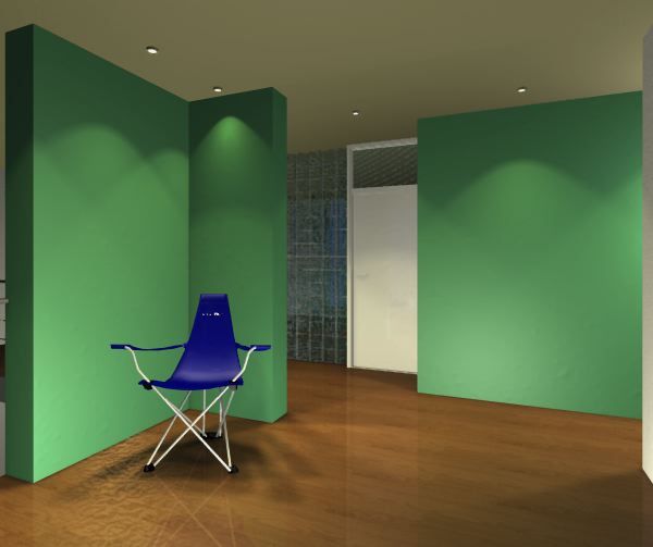

As you see, I have following problems:
I illuminate the ceiling with general lite. But it looks little bit holloween....
I put hallogen lamp over the chair, but the color of wall is no more white (the actual material is white plastering wall)
Please help..... rescue me from holloween....

The GDL code used to generate light have nothing to do with the object looking like a light source. The appearance of the lamp is a separate issue. Make the discs of your downlite constant reflectance white and see what happens.

I meant "constant reflectance".
Still I could'nt find constant reflectance.....
Maybe it is because of English.....
I made downlite color to white, but it looks not real and very cold.
I did your yellow color.
The problem is ceiling. I put 6 general lite with 7% intensity, and with your yellow color.
It is still not 100% satisfied, but I must say, I had never such like good rendering.
It thanks to you.
