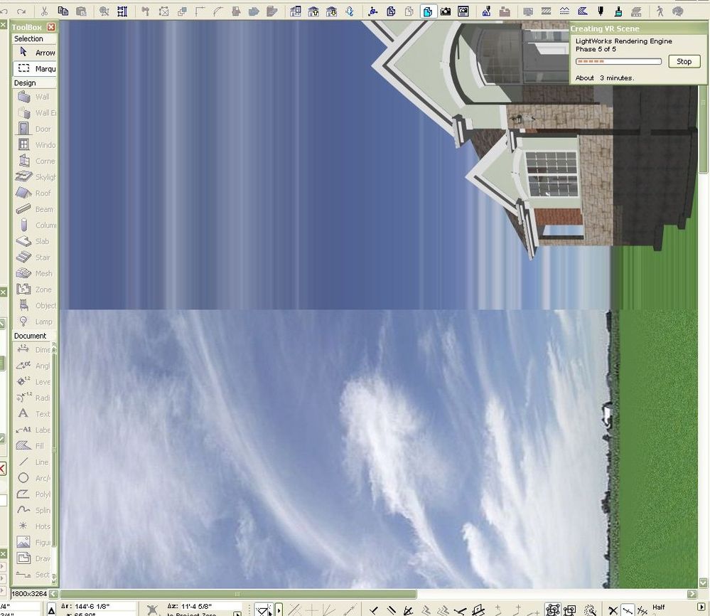

I am having an issue with the background in my VR Scene / Panaroma using Lightworks rendering. There may have been a thread related to this issue, but I have not found it. We have a standard background image sized at 3264x1800 in .jpg format which we always used in ArchiCAD rendering. But we have not have had any success in making it work in LW rendering. When it actually appears in the rendering- it is so blurred and stretched its no good. If I select no background, the image appears before the rendering covers it and its all black. Any guidance will be helpful. Thanks.

I will attach my settings and a snapshot of the rendering in progress:
Here is one shot of the settings
And another shot of settings

turn off camera - coalminers - light
Since you have no special effects going on, try "render background with internal engine."
