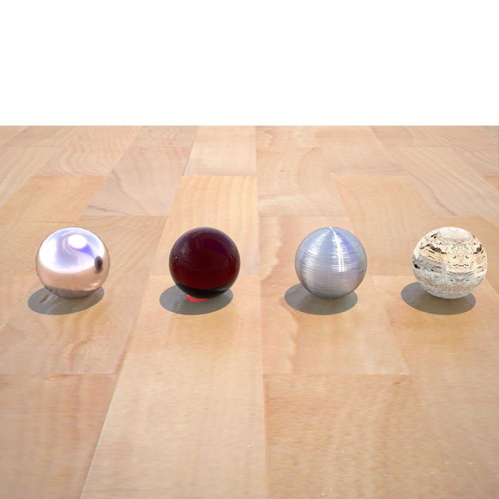

Testing some materials that i will be using in my next scene. I used the Physical Sky and an HDRI sky map for the reflections. I was wondering if anyone has had the problem of rendering out of archicad and the depth of field is way out of sink. I am starting another exterior scene and i did some test lastnight. I found my scene with a depth of field that was so bad it was hurting my eyes to look at it. Either i was that sleepy(didn't go to bed until 4:15am) or my settings were really messed up. I would like to see other users of the plug-in comment on this issue. Hope you guys like my material test
Hi kjverine,
About DOF - if you render via plug-in make sure your target is in range, do it by "Look to -> Target Point" from 3d navigation pallet, to avoid shallow DOF increase F Stop of maxwell camera to 10 or even more.
I found also that film settings are tenfold comparing to what we used to in Studio (and real camera settings), so make sure you divide it by 10 when putting values.
Some general thought: even though new plug-in is a great improvement I still get better results by using Studio, from the other hand having Maxwell under ACad roof make the workflow a lot more comfortable.
