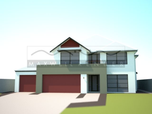

OK, here goes...
Your rendering is out of focus.
To focus right click and select autofocus.. or focus on a selected object.

1. Toyland. The toyish quality is a direct result of the camera modeling that Maxwell does. It is not a fault, but a feature. We have been accustomed in our previous rendering applications for everything to be infinitely in focus. Not what happens in real photography (usually). In fact, even realworld scenes when photographed can look like toys. Here are some examples of real scenes that look like miniatures.
http://www.discover.com/issues/jul-06/rd/toys/
http://www.flickr.com/photos/yongfook/sets/72057594076771629/
Play with this tool and you can begin to get an understanding of how Fstop, Shutterspeed and focal length / depth can affect scene scale.
http://atillaakin.com/maxwell/dof.html
Using higher FStop settings like 10-18 with a slower shutterspeed like 250 will approximate architectural photography.
