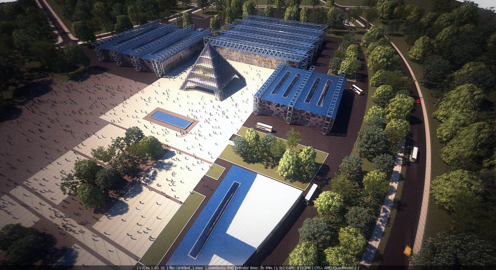

Do you mean like these?
Second _view
Third......
............and another......
Last one.....
I only did these 5 because I don't know which specific views you wanted. You should learn how to save views and viewpoints from the 3D window in ArchiCAD so that it's easy to access them later on. Either that or next time it might be better to post a screen-capture of the views you want to render. If other people are unable to help you with the remaining views, I might do them later on if you post the screens or views.
The reason you can't render it on your machine is because you had a lot of heavy,...and I mean HEAVY objects (Polygon-wise) most specifically the Trees, the people and the worst offenders, the water fountains (frankly speaking I don't know, how this particular gdl object is useful at all).
I have no idea how you were even able to work at all in ArchiCAD let alone render with all the geometry you had in that file and with your machine (512MB of RAM??? Do they still make those?). Considering the fact that ArchiCAD had a hard time handling the file ( as I would imagine it was in your computer), it's highly unlikely that you could get it to render in Lightworks with all that stiff.
Consequently I got rid of all that stuff to allow my to export it to 3DS Max, which can handle heavy geometry better than ArchiCAD can (to a limit, obviously), and then replaced them with Vray proxies of the Trees and people. But normally if you have a slow computer it.s better just to use billboards (2D bitmaps of the trees and people) which are easier on the computer and easy to work with. But of course with them you can't do overhead views.
Next time try to be economical with your modeling if you intend to render it and limit the heavy geometry which slows down ArchiCAD, and sometimes gives a lot of errors (like the library errors you were getting), and worst of all make it difficult, if not impossible to export the model to render it in another program that can handle high geometry files.
I hope this helps.
Have a Merry Christmas.

Bricklyne fantastic images! Fantastic Rendering! Thank you, thank you, thank you. I will return the favor to you some day.
Ok, just to make it clear - you have just removed all the trees and people from the .pln file (not buses?) and exported it to 3ds max format file, then loaded it to the 3DS max and then what? I haven`t understood you this part:
