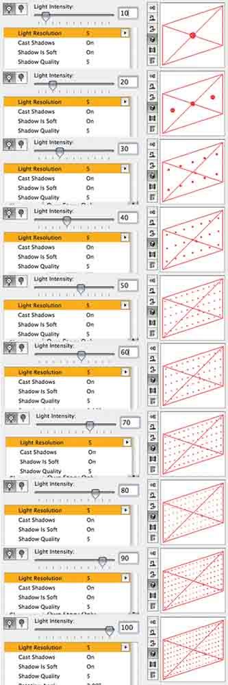

I was getting the same error. Rather than simplifying the model, cutting down on the number of Lightworks windowLamps in other "invisible" rooms helped get rid of it. Probably the same for other lamps too, I dunno.
Even with a real lamp fixture placed in the scene, the checkbox for light intensity seemed to have no effect, so I also make sure that it's intensity value is 0, for a daylight shot.
Dwight
Eliminating Windowlites isn't simplifying the model?
The windowlight is a dangerous and time-expensive element since is has an enormous range of complexity and can generate many extra, time-consuming calculations.
The only windowlite that should be operating in a model is the one in the window facing the sunlight and is prominent in the scene.
Observe in the attached how many extra light sources you get by innocently increasing the intensity of a window lite.

Dwight Atkinson
Well that wasn't in the AC manual. Looks like I'm gonna have to get ya book, Dwight. This trial and error method just aint workin for me
Dwight
I learned the windolite the hard way, using top quality/top power lights and wondering why a small animation frame was taking 20 minutes.
