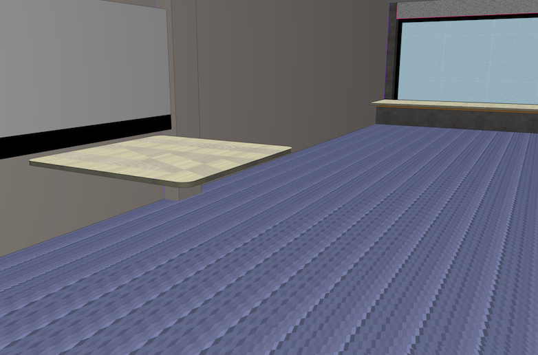

I am having a bit of an issue with surface texture. In 3D view, all textures are showing pixelated. This includes Archicad's own surface as well as custom textures with texture image loaded on.
Has anyone else similar problem before?

Is your model a very long way from the project origin or is there some elements that are very far away?
This can cause this problem.

Thanks Barry that was the issue. We had some elements very far away but also the model was drawn a long way from the origin point.
