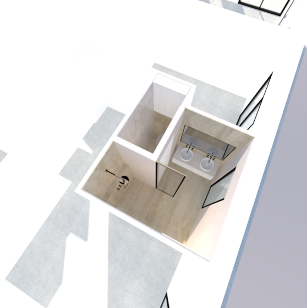

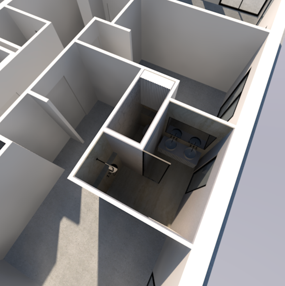

I want to render an axonometry without a ceiling and I struggle with the light In Archicad.
How could I simply have a clear room without any kind of shadows (or not too strong) knowing that at this stage I don't want to add any lamp or spot ?
I have tried to move the sun but it doesn't really help in any way..
Thanks!

I'm assuming you aren't using Redshift render? You can turn off shadows in Cinerender in the detailed settings...
https://help.Graphisoft.com/AC/25/INT/#t=_AC25_Help%2F140-2_CineRenderDetailed%2F140-2_CineRenderDet...

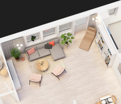

You can use an appropriate HDRI for the overall lightning and then add a few lights if you wish. This is an example I made:
