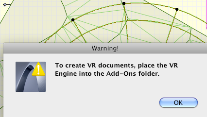

Does anyone know where I can find this file. I have searched for VR and placed all APX files into the add-on folder, restarted AC14 but I am unable to produce a VR Object, receiving the attached error message instead.
Thanks and Happy New Year,
Scott

This thread might be useful:
simple QT movies with AC 14?
David

David,
Thank you for the link explaining the issue.
So basically AC14 cannot produce a VR document any longer even though it is available in the menu. The only other choices are to either back save to AC13, then use the Deprecated QTVR Add-Ons found here:
http://www.graphisoft.com/support/archicad/downloads/ac13/QTVR.html
or to use Cinima 4D, Artlantis Studio or Graphisoft's VBE.
