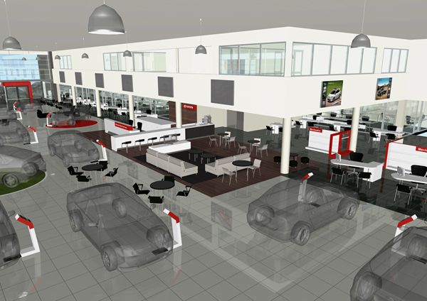

In my project I have used the "picture 14" object with custom images in several different locations.. However, for some reason, when rendering in Lightworks.. the picture objects with rotation of 90° rendersing the images correctly however those with a rotation of 0° the custome image is hardly visible..
Does anyone one have any advice - What am I doing wrong

Are you sure that the pictures are not facing the wall?
David

Yes I am positive the are not facing the wall.. each picture has the same material - I drag a copy and rotate..

I have just downloaded Dwight's Parapicture and this works perfectly so am going to use this instead - saved the day again Dwight!
Thank you both for your help, as usual

Have you tried just rotating these a further 180°?
There was a post recently abiut the Picture 14 object where we discovered they have put a backing board in iot so the image can't be seen from behind.
