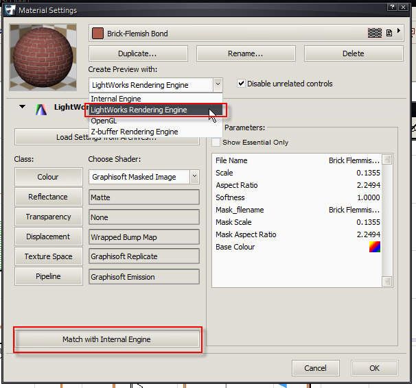

Can someone help me? I have choosen my own wallpaper that I have saved on my computer and put on one wall but when I photorender that wall the wallpaper is not visible! Its only a white wall. What do I do wrong? Its visible when I work in generic perspective.

sounds like you applied the texture to the Internal Render Engine settings, but not lightworks. Go into the Lightworks settings for your material, and hit the 'Match with Internal Engine' button. Screenshot attached.
