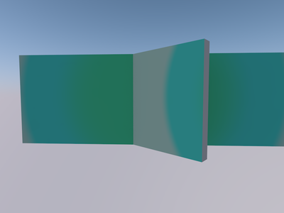

Fresnel: it will override the surface texture
Cinerender Redshift

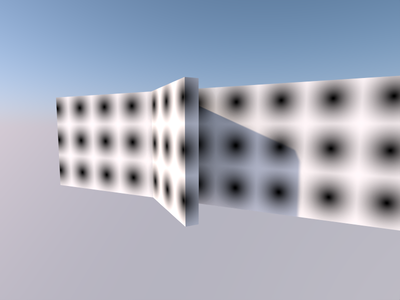

Gradient: complete misalignment of the texture in case of 3D types
Cinerender Redshift

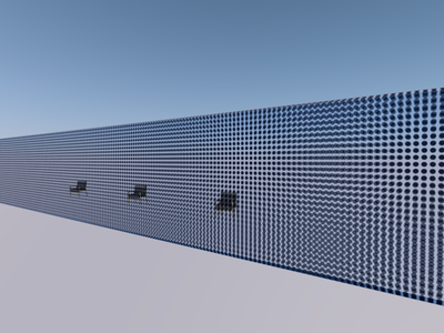

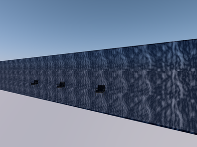

Procedural: mostly misalignment of the texture
Water
Cinerender Redshift

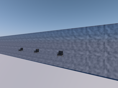

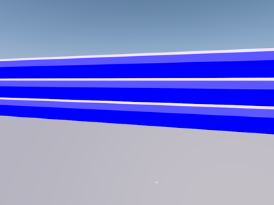

Simple Turbulence
Cinerender Redshift

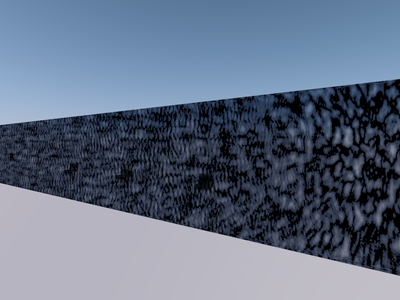

Venus
Cinerender Redshift

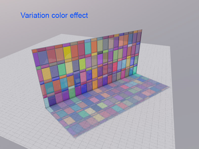

Variation
Cinerender Redshift

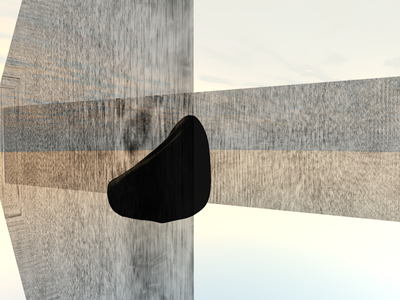

Shader Effect and Sketch: may not work correctly
Projector
Cinerender Redshift

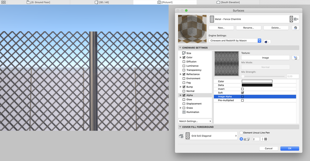

Alpha channel may not work as expected on macOS
To render transparency, it is recommended to turn off Image Alpha option.

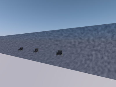

  • Foliage - Wild grapes / Leaves Tree Small: the sun highlights the texture, thus Reflectance channel should be turned off in Surface Settings

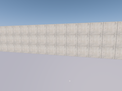

  • Concrete - 02: rendering with Low quality preset will result in much worse texture (higher quality will provide better texture backing)
  • Insulation - Fiberglass: Alpha channel in Surface Settings should be turned off

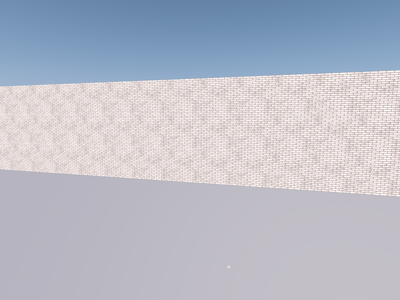

  • Metal - Nickel: the texture becomes black in the render. To avoid this, the Reflectance channel should be turned off (other metals may differ from defaults due to alpha and reflectance layers)
  • Pavement - Brick Moss: the texture can be fine-tuned without using the first Noise layer in the Color channel (Surface Settings) or by modifying the Noise layer's Blend Mode and Blend Strength value

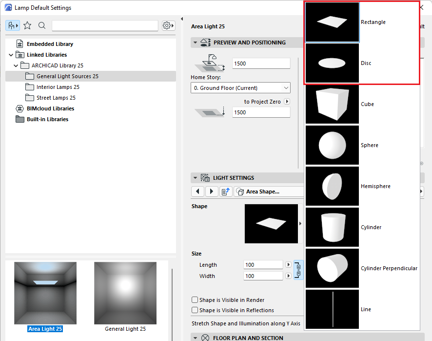

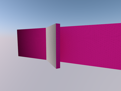

Area Light: it only works with Rectangle and Disc shapes in Redshift
Redshift cannot render other shapes, or the light cannot illuminate

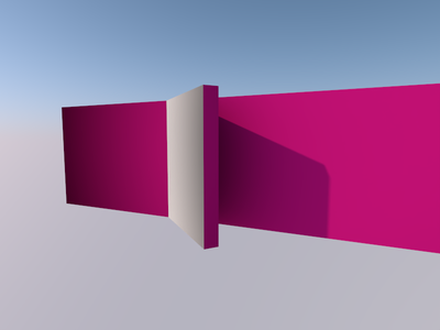

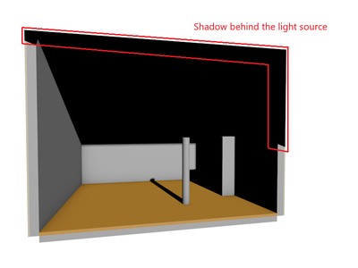

Parallel Light: there is no shadow behind the light source in Redshift
Cinerender
Redshift
