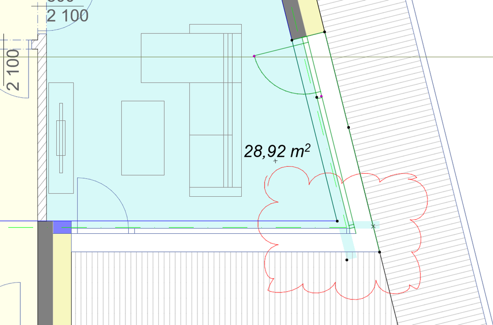

BUG: incorrect zone calculation for the corner window made of two elements
ZD
When using two windows with custom corner and zero height window-sill, the Zone tool are unable to count the floor area correctly - see the image attached.
The problem does not occure if I use "Corner window" instead two separate window, but the tool "Corner window" itself is limitated in design parametres and we do not want to use it.
