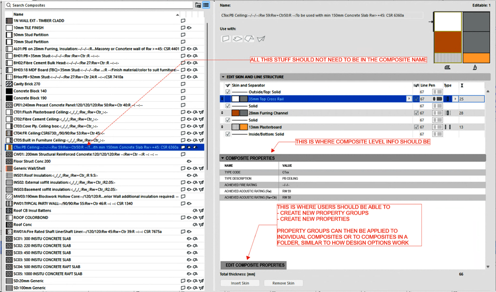

Currently the only data field available for composites is their name.
Using a very cumbersome workaround, we can name the composites in a particular way, putting all the relevant info into the name field, then we can split the info using expressions, however this is a very clunky and error prone workaround.

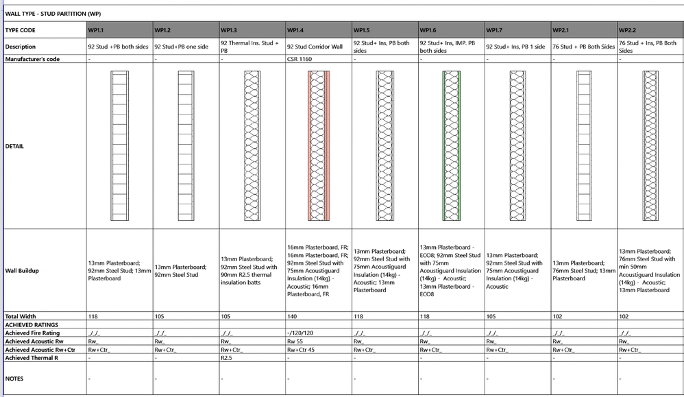

A wall type legend, similar to below is commonly used.

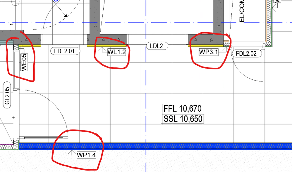

These wall types then are annotated in plan view using labels.
Attribute level properties should be edited at each attribute's editing window.
These attributes belong to that specific set of attribute only, not used anywhere else.
For example:
Composits should have their own set of properties / custom data fields that should be set up and edited in the Composite Settings dialogue box.
