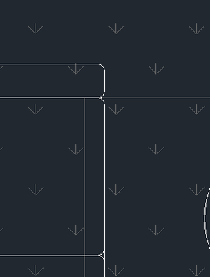

Hi all,
This wish is for the ability to automatically trim Fill to Hatch conversions to where they are visible in Archicad.
When exporting DWG files we have the ability to convert fills to specifc hatch patterns but often the fills of one element overlap fills of another. Unless you incude exporting Fill Backgrounds as additional Solid Hatches, you often end up seeing hatches where they should not be... It is not rare to have a Fill in AC purely for the purpose of hiding some other element...
This would be related to how Archicad cannot flatten a PDF and hence exports layers of everything that is not even visible...
Ling.
