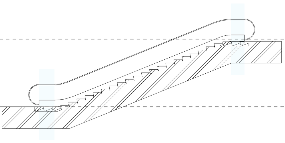

We experienced a lack of the following features while working on our projects:
— The thickness of the Truss is limited to 1m as a minimum. It seems that manufacturers can make it thinner, and on many occasions, it is quite important to know and show exactly how much space is left below an escalator. (I did a "subversion" of the escalator, where I changed the limit "wired-in", but I am sure many other practices would enjoy a bit more flexibility there.)
— The horizontal ends of the escalator often need to be longer, than the value automatically calculated by the script (blue areas on the screenshot attached).
