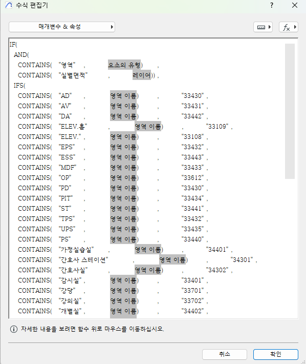

Request:
While using the Expression Editor in ARCHICAD’s Property Manager, several usability issues have been identified. I’d like to request the following improvements:
Suggested Improvements (4 items):
  1. Add Scrollbars — Add draggable horizontal/vertical scrollbars to the right or bottom of the formula editor to easily navigate long expressions.
  2. Line Break Loss Issue — When pasting formulas from Visual Studio Code or Excel, all line breaks (Enter) disappear, making the formula appear as a single line, which is very hard to edit.
  3. Parameter Recognition Issue — After pasting, parameters are converted to plain text. Only after pressing Ctrl+Z once, they return to recognized parameter format.
  4. Performance Improvement — When formulas or functions become long, the editor slows down noticeably, causing input lag and performance drop.
