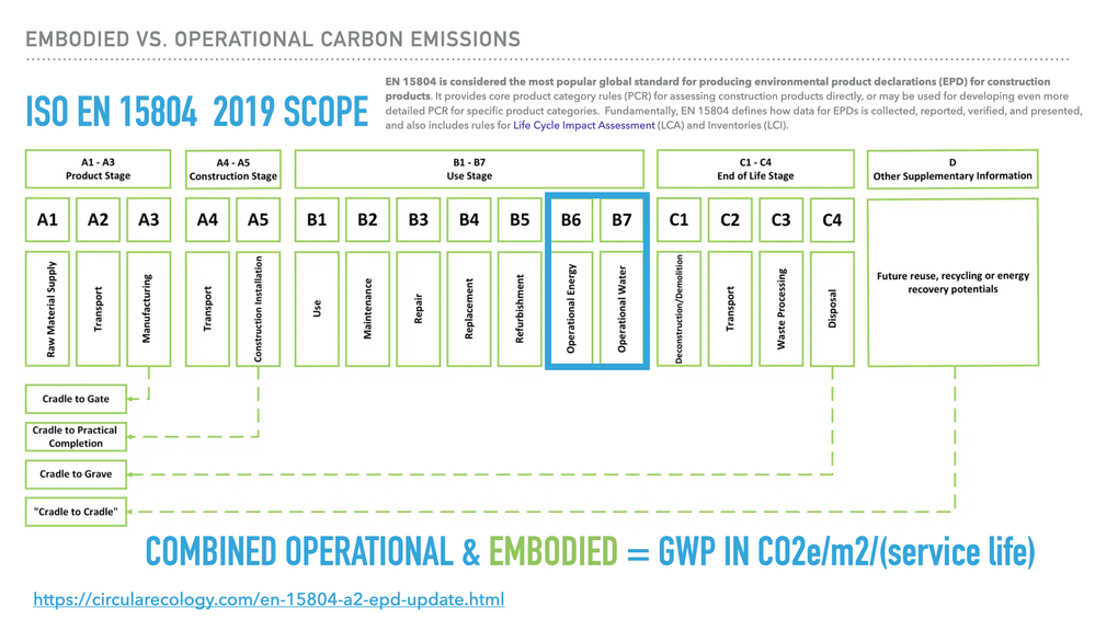

@Balint Kezer we do still need to expand the xml file 'materialcatalog.xml' to support more than just A1-3 categories. Full scope is here. This simple move would allow advanced users to build out and customize the materials database to their local market as needed, with more than just a summary of A1-3. While we can currently add as many materials as we like to this xml file, ArchiCad will only 'read' one cell/field (typically a summary of A1-3). This is as simple as adding support for A1, A2, A3, A4, A4, B1, B2, B3, B4, B5, C1, C2, C3, C4 and D fields.
The harder part to fully support LCA in schedules is to allow doors and windows to report their materials to the schedule - currently only basic elements can do this. As this is now an emergent part of building permit requirements across the EU, NA is quickly following suit (NYC, Toronto, Vancouver, California all have similar legislation on the books) and this will be in our (Canada) National Building Code in the 2025-2030 cycles.
