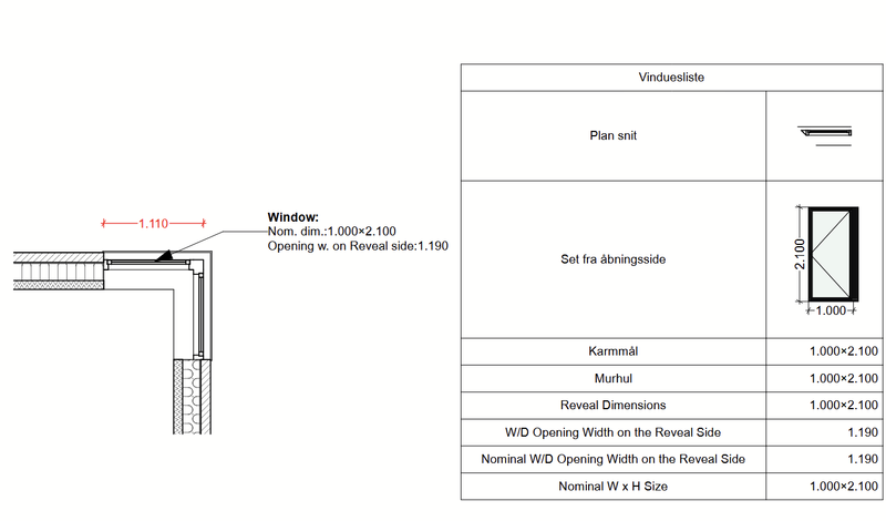

Relating to request #245503, we found that there´s a limitaiton in the values collected by AC in relation the corner window;
The Actual width = Window element + the extra corneringframe element
Can this please be added / calculated, in order to call the right dimensions in a schedule.
The dimension marked with red pens can´t be found anywhere in the system, or maybe I´m missing something here!
