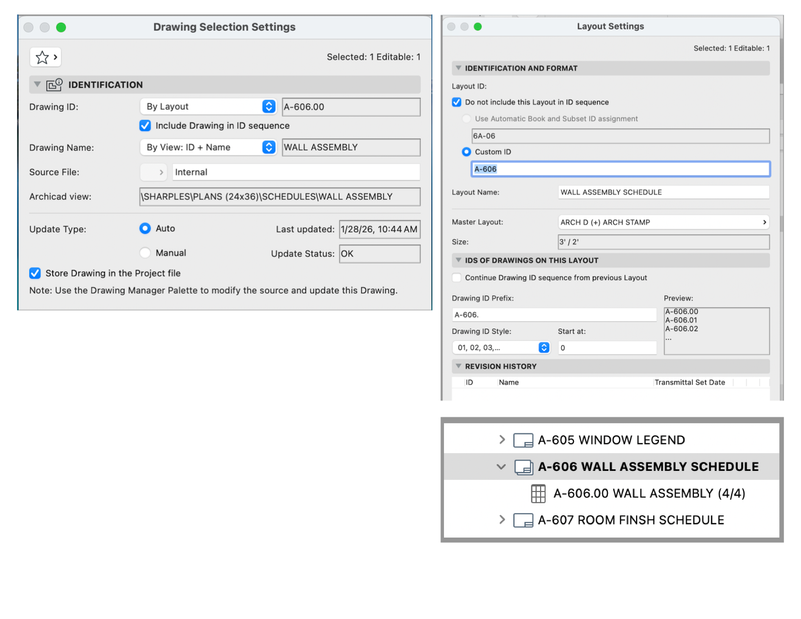

For the life of me, I cannot figure out how to publish a layout with a "Split drawing among multi layouts" with sequential layout IDs??  This feature does not seem to work.
And, yes, we all understand that employing a subset is not required to accomplish this task, nor does it make it easier.  I have already tried using subsets with zero success.
I wish I was a newbie to Ac, but I have been using Ac since version 4.  Even my GS/AC reps, Chris Clark and Kevin Wichmann (whose names you may recognize), cannot figure out how to successfully use this feature.  It has become another layer of frustration for all of us.
I have attached a screenshot showing a few of my settings for you.
In short, I am trying to create the following sequential id format: "A-606.00, A-606.01, A-606.02."
My base "A-606" layout is my wall assembly schedule layout or sheet with the spilt drawing, and all the subsequent drawings should have this A-606 prefix.  I use the Classic NCS Format for my sheet IDs and I see no reason why this should be a factor in the final result?  If it is, this should be fixed, everyone has their own method for labeling layouts/sheets.
