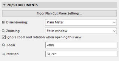

I would like to have the possibility to read (and hopefully modify) saved view orientation and zoom settings directly in the view settings window.
The problem is that if you save a view with rotated orientation but check Ignore zoom and rotation when opening this view you have no option to retrieve that information other than unchecking that box and opening the view or finding out that your view is rotated on a Layout. It can become really annoying to be honest.
Below is a quick mockup of how I imagine it being implemented (maybe we could even edit it from that point).

Yes, definitely one that would be useful. Especially the view orientation as an actual degree.
The way the view settings is at the moment, with just a tick box for 'ignore zoom and rotation' is too basic, and is a tortuous process when wanting to have different orientations on different drawings.
I would remove "ignore zoom and rotation" altogether or reword it, as I can never seem to figure out if it is ignore what it is set to, or ignore what I am on!
