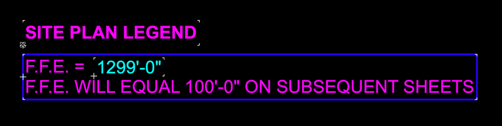

Problem: If we want to display the project's Sea Level (it's value, not an elevation to an element relative to SL), we have to type it manually, or use a workaround. In other words, the project's Sea Level value is only available to dimensions.
Scenario / Use Case: We want to display the project's Sea Level in our Site Plan Legend, as a way to communicate the relationship of our Civil engineer's FFE elevation (given relative to Sea Level) to our Architectural FFE elevation, which we always designate First Floor FFE as 100'-0". See attachment, which shows our current workaround. I have placed an elevation dimension, relative to Sea Level, and just moved the dimension text to roughly where I want it in the legend.
Wish: That Location Settings be available to call in Properties / Autotext.
