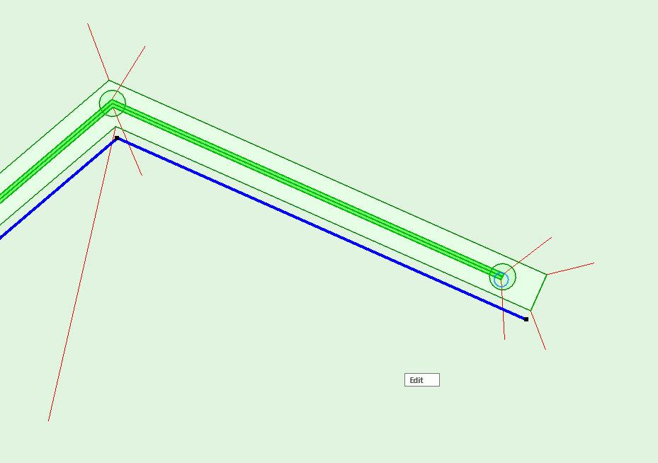

Add more anchor points to the railings; every edge/contour should be selectable (similar to Morph)
2 Comments
Every corner or end node of all the railing components can already be snapped to - it is just there are no visible nodes at those points.
The mouse doe snap to those points.
I can't show the cursor in this screen shot, but see the red lines snap to the corners.
And when you associate your railing to your element, there is no need for nodes as it will follow the edge of the element (with an offset if you want).
TheilerLino
Thanks for the input. In the floor plan, this is not a problem, but I would like to have more control in 3D.
