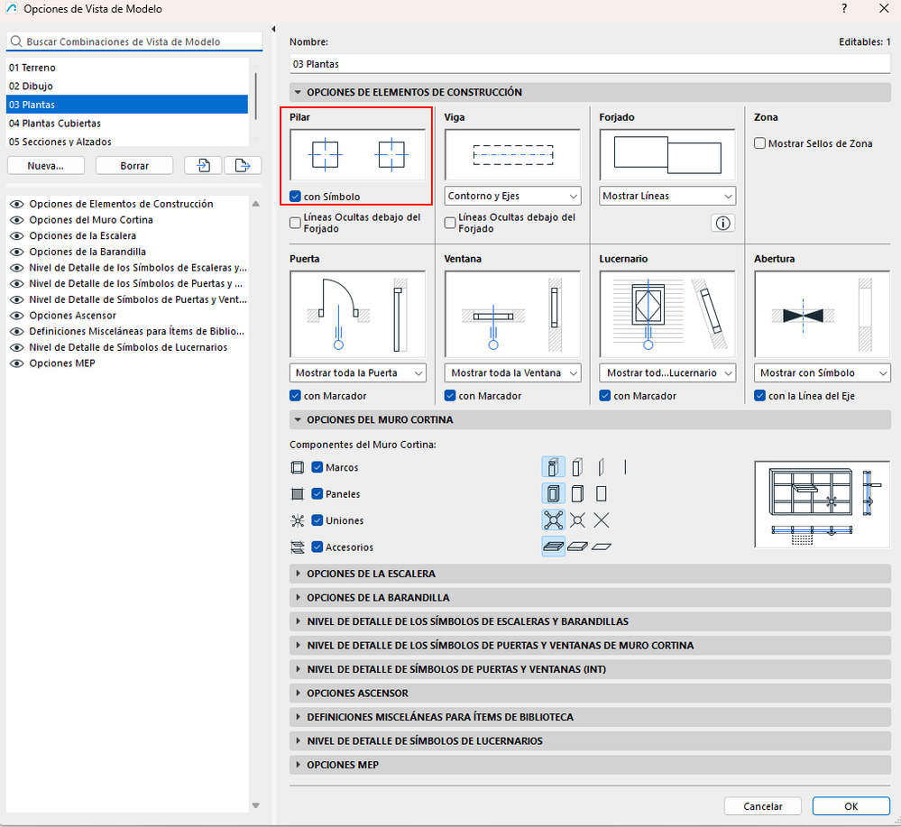

When we work share the project with the structural team, we have to mark the fixed point of the columns, from where they can grow: center, face or corner. Something like this:
If we use the rectangular column, we can use the anchor point to place them in Archicad, but if it's activated the symbol in OVM, it will always mark the center of the column... never real anchor point.

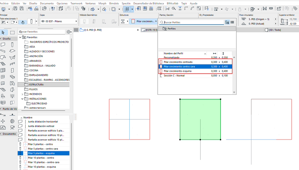

Now we are using a workaround: 3 complex profiles with the origin in those 3 points, combined with the only symbol that works properly (cross). But it's not so easy to use, because if you have columns placed and want to change the fixed point, you have to change complex profile, rotate, and dimmensions reset to the original ones.
So I think it would be useful:
- Symbol pointing to real anchor point of the column
- Another type of symbol, more visible. The cross line it's difficult to see sometimes. Maybe a circle, a rotated square...
