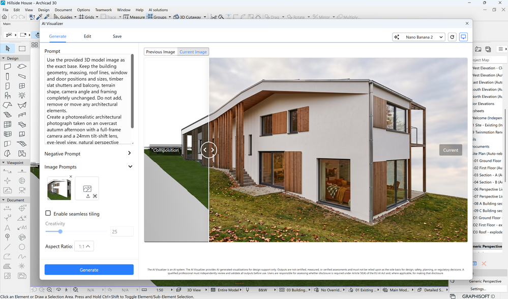

Here is a step by step instructions on how to do that:

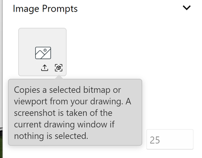

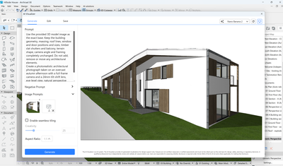

1. Capture the 3D model from your active 3D view
2.Then paste your prompt, in this example the prompt used was:
Use the provided 3D model image as the exact base. Keep the building geometry, massing, roof lines, window and door positions and sizes, timber slat shutters and balcony, terrain shape, camera angle and framing completely unchanged. Do not add, remove or move any architectural elements.
Create a photorealistic architectural photograph taken on an overcast autumn afternoon with a full-frame camera and a 24mm tilt-shift lens, eye-level view, natural perspective with vertical lines kept straight.

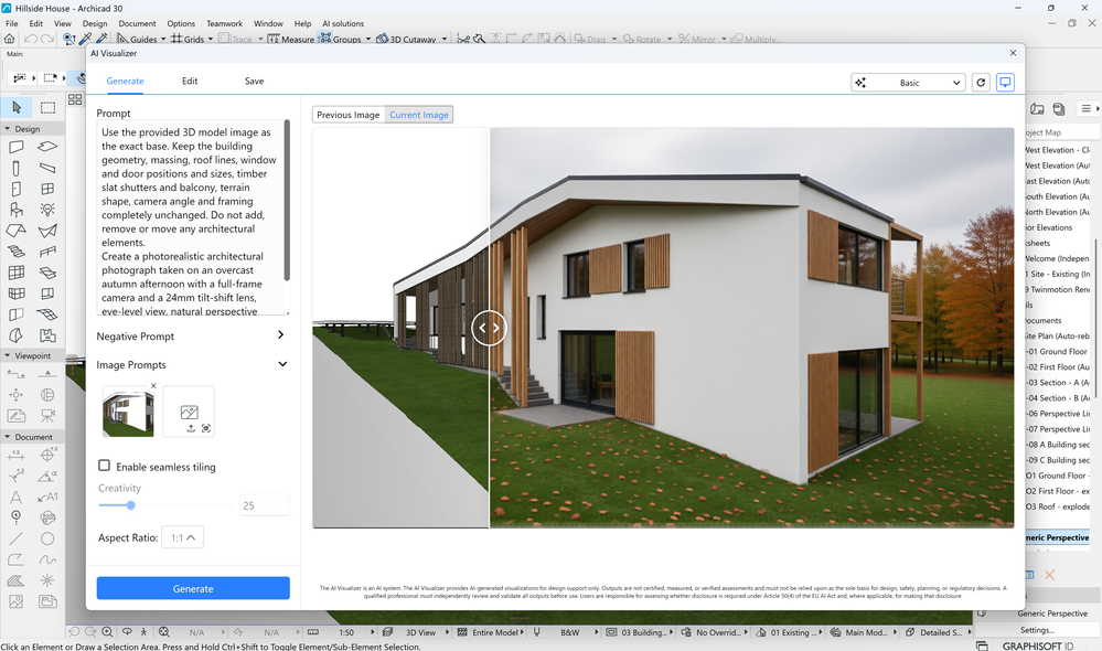

Result using the basic model from AI model selector:
Result using Nano Banana 2 from AI model selector:
