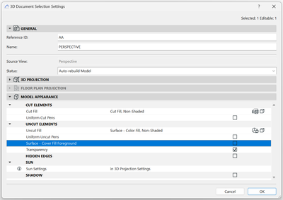

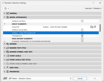

Hi all,
I am looking to find the correct attributes to turn on / off the 'Surface - Cover Fill Foreground' parameter for API_DocumentFrom3DType and API_SectionSegment. I can find the transparency control for both but not the Surface - Cover Fill Foreground.
API_DocumentFrom3DType documentFrom3DType
documentFrom3DType.transparency
API_Element element
element.elevation.segment.transparency
Any help appreciated.
