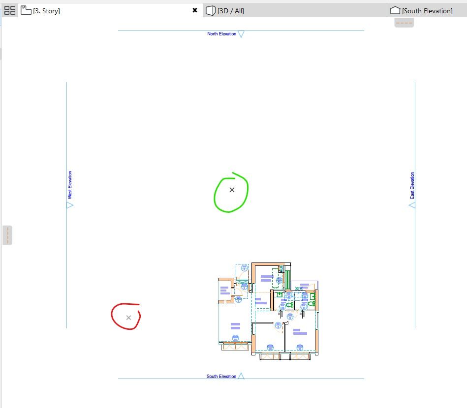

Hi
Anyone has an idea how can i place/create a hotlink element based on 2D API_Coord (x and y positions)?
I did some testing and for an Object Element, the position is referenced to the Project Origin (If my understanding is correct)
Red = Project Origin
Green = User Origin
Where Obj pos.x = ~0.0 and pos.y = ~0.0
But when I created a hotlink element with x=0, y=0, z=0 coordinates it was placed here
Im using this code from the example references to convert 3d coordinates to API_Transmat
