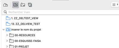

1. Creating a View Map view while leaving the destination parent unset does not fail and does not fall back to a sensible container - it attaches the new view directly to the View Map ROOT node, outside every folder and subset. The Navigator palette has no place to show such an item cleanly, and Archicad itself never creates views there.
2. A view in that position can then never be removed. ACAPI_Navigator_DeleteNavigatorView returns NoError but is a silent no-op - the item is still there on the next read. ACAPI_Navigator_ChangeNavigatorItem cannot move it into a real folder either (fails with error -2130313112, "Failed to move navigator item"). And it cannot be deleted by hand in the Navigator palette. The project is permanently stuck with the orphan view.

The resulting item, read back via ACAPI_Navigator_GetNavigatorItem:
- itemType: story item (a clone of a Project Map story)
- guid: valid, resolvable (GetNavigatorItem succeeds, GetDatabaseId succeeds and returns the floor plan database)
- parent: the View Map root node
- isIndependent: false

4. Read the View Map tree again - the view is still present.
5. Try ACAPI_Navigator_ChangeNavigatorItem to move it into a real folder.
-> fails with error -2130313112 ("Failed to move navigator item").
6. Try to delete it by hand in the Navigator palette.
-> not possible.
