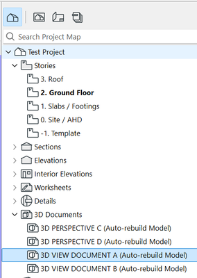

Can I change the name / id (uName/uiUd) of a 3D Document in the Project Map through the API?
I have tried using ACAPI_Navigator_ChangeNavigatorItem, which returns NoError, but the 3D Document doesn't change in the Project Map
Thanks,
Danny
API_NavigatorItem navItem2Change{};
navItem2Change.mapId = API_ProjectMap;
err = ACAPI_Navigator_GetNavigatorItem(&navItemGuid, &navItem2Change);
if (err == NoError) {
	navItem2Change.customName = true;
	GS::UCopy(L("PERSPECTIVE"), navItem2Change.uName);
	navItem2Change.customUiId = true;
	CHCopyC("D", navItem2Change.uiId);
	err = ACAPI_Navigator_ChangeNavigatorItem(&navItem2Change);
