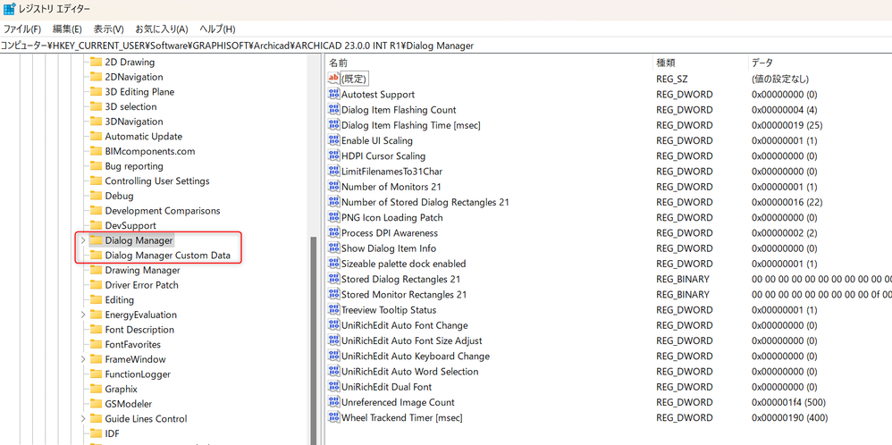

Hi, Could you try to run Regedit.exe, then remove 'Dialog Manager' and 'Dialog Manager Custom Data' folder to see whether it can update the add on?
HTH.
