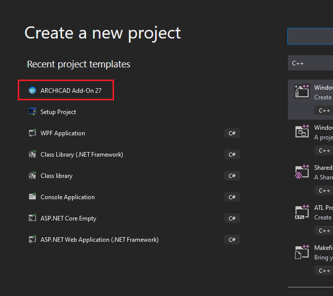

On the other hand, I have tried to create my own template to avoid all this CMake nightmare, but without success...
Wouldn't it be easier for Graphisoft programmers just to create templates for each Archicad/Archicad API version?
Regards,

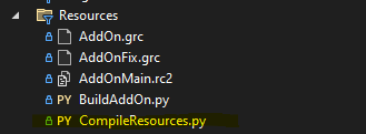

Setting up your own template is quite an involved task because of all the things you have to get right. Especially resource compilation is not easy to setup in my eyes. A possible alternative would be grab some old API release and adapt these for newer AC/API SDK releases. The AC25 SDK was the last to provide Visual Studio Project files for the examples.
I think Graphisoft is providing cmake templates since they can be used both on Windows and macOS without much adaption. If they were to create a Visual Studio template, they would also have to make a XCode template (which they have done in previous versions before switching to CMake).

i found it very intresting to see the link to the ressource builder that gets his variables trough the python file in the solution.
it shows impressive waht complicated system is in place to build a plugin. 😃
if you analyze this file it should become clear that you cant just copy pase a template an use it for anothe plugin since all the variables are set in the chache file. i would not recommand to try to rename all the variables manually.
