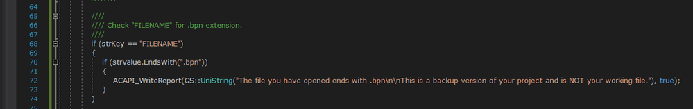

I am trying to solve a problem of our users opening .bpn files from the recent files list instead of the corresponding .pln file.  I have a couple of things in place - one of which reads, at opening, the value of the "FILENAME" parameter from Project Info... and determines if the file is a .bpn file.  I do that with ACAPI_Notify_CatchProjectEvent and APINotify_Open in the Initialize() function of the menu load and catch the file extension prior to anything being loaded in the drawing editor.  A user defined function is called  to determine the file extension and displays a warning dialog.  I do that with this code in the function:
If a .bpn file is detected, a dialog appears with a warning and the opening of the  model stops.  The warning dialog will eventually become a much more severe version of this:
I would  like to  cancel the opening of the .bpn model completely, once the user presses 'OK' and not have to depend on the user reading or following directions.
I have searched high and low without success.  Can someone point me in the right direction to programmatically cancel [File > Open] ?  Or maybe execute [File > Open] to a new, blank file?  Is it possible at this particular stage in the open?

It is not doable with APIDo_OpenID in the specific needs of my situation.
https://community.Graphisoft.com/t5/Developer-forum/ACAPI-Automate-OpenID/m-p/218492
The same rules apply for APIDo_NewProjectID.  The search continues...
You can  follow my chain reaction from the initial call of ACAPI_Notify_CatchProjectEvent to APIDo_OpenID here:

			//// Check "FILENAME" for .bpn extension.
			if (strKey == "FILEPATH")
				if (strValue.EndsWith(".bpn"))
					ACAPI_WriteReport(GS::UniString("The file you have opened ends with .bpn\n\nThis is a backup version of your project and is NOT your working file."), true);

Hi Chris,
that's unfortunate. I wasn't aware about the restriction regarding the Notification scope. Unfortunately I can't think of another solution via the Archicad API.
Maybe a workaround via a AHK, AutoIt or some other Windows GUI automatisation could work. With those you could maybe detect the dialog and a .bpn string and auto stop the loading of a bpn file.
